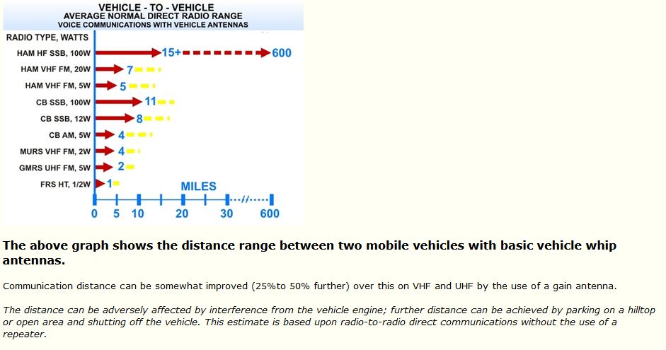

This chart might be of some value:
That was lifted from here: http://www.survivalistboards.com/showthread.php?t=304478
If you want to compare apples to apples it would be a handheld ham vs a handheld CB, but I think many folks are actually comparing a handheld ham to a mobile CB. Not quite apples to apples. But I bet the price points are close, and price is what folks look at first.
