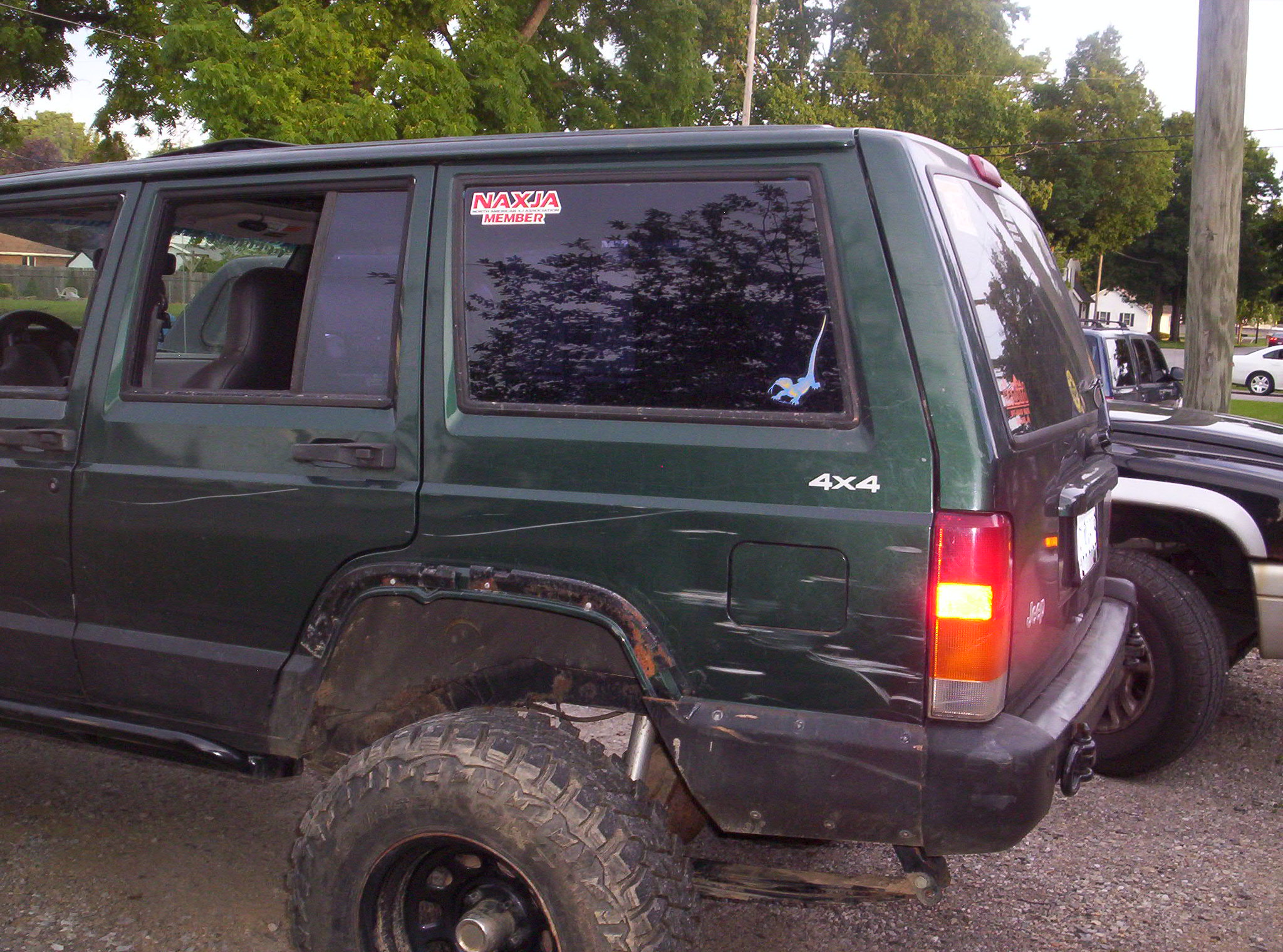

damaged enough body on the driver side that door is almost not able to be put on...much less closed.

• driver rear quarter dented & taillight cracked
