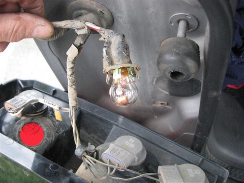

As an alternative to utilizing the existing XJ tail lights, connected through diodes, is to add an extra set of bulbs in each housing and eliminate any cross connection.
Eliminating the diodes also raises the voltage that the tail lights see.

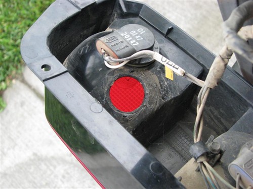

I drilled a hole in each tail light housing and used a snap in tail light socket, A fresh set of four-wire cable was run from the tail lights to the front bumper where a 7-pin plug is located.
I used this tail light kit. The bulbs has since been upgraded to LEDs.
https://www.rvupgradestore.com/Bulb-Socket-Tail-Light-Wiring-Kit-69-p/bx8869.htm
https://www.flickr.com/photos/lwade/sets/72157603323570942/with/46669859632/
