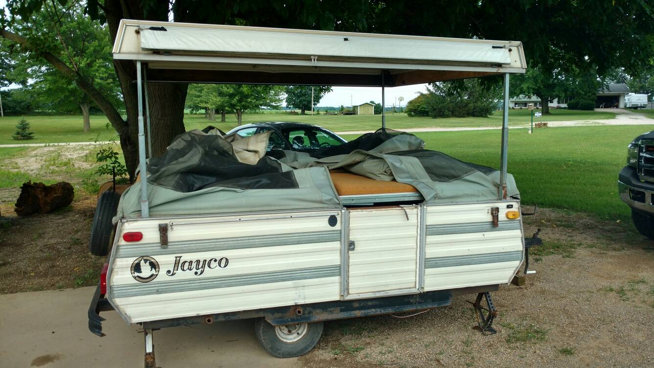

The plan for this trailer is to be able to mount our old pop up sideways on the front of the trailer and be able to put the jeep on the back. Will be a lot easier than the tandem towing I had been doing the past couple years.
Here is the camper that is gonna be mounted on the front
